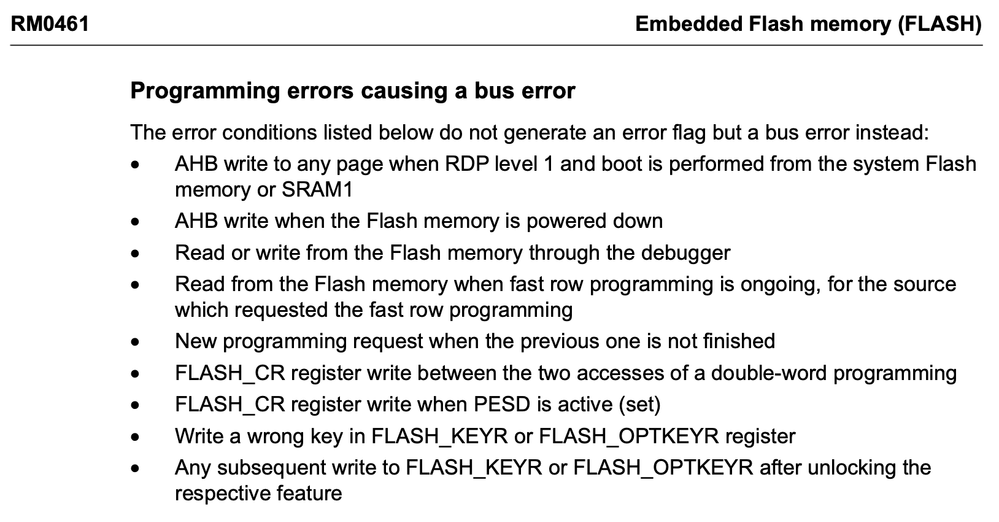

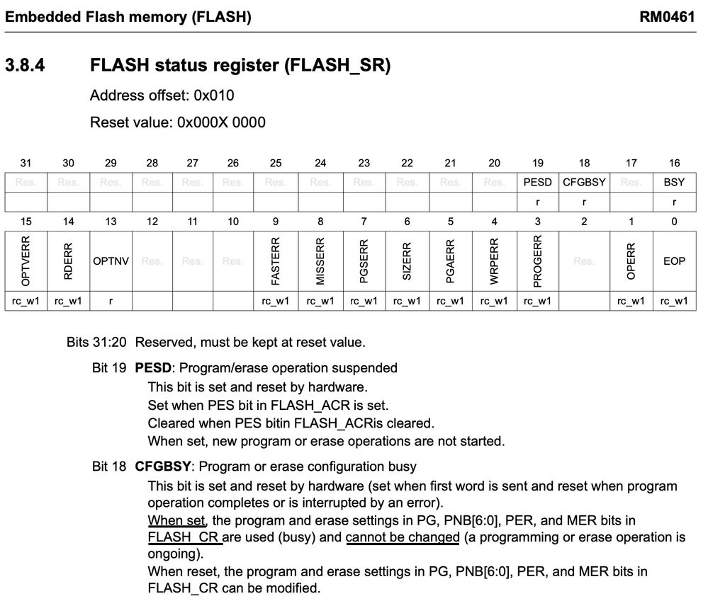

From the documentation:
Interestingly the doc says nothing of the CR LOCK/OPTLOCK bits being inaccessible when CFGBSY.
The application at that point is not aware of the issue. Further a FLASH write is done and the CPU enters a Bus Error when trying to access the CR register to Lock the FLASH Memory.
From de Documentation:
The documentation says nothing about Bus Error in case the CFGBSY bit is set when accessing the CR register LOCK/OPTLOCK bits.
