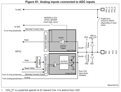

Here's the figure showing the hardware architecture of the PAx_C pins and how they relate/connect to the PAx ones.

Only big packages have both PA1 and PA1_C as shown on the table at the bottom of the page: TFBGA240+25, UFBGA176+25, UFBGA169.
On these packages, you can have e.g. ADC1_INP17 on PA1 and ADC1_INP1 on PA1_C with the analog switch open. In this case, ADC1_INP1 is a direct channel and ADC1_INP17 is a slow channel.
E.g. for the STM32H755xI, slow, fast and direct ADC channels identification is given at the bottom of Table 97 in the datasheet DS12919 Rev 2 with their characteristics inside the table.
Of course, on such a package, it is possible to use PA1 for another digital or analog function instead of ADC. But in this case, PA1_C can only be used as direct ADC channel with the analog switch open. That's  the reason why on your picture other functions are shown in red in STM32CubeMX.
The same, it is possible to use PA1_C for a digital or analog function with the switch closed. But in this case, the PA1 can't be used at all. On big packages, I wouldn't recommend to do this.
