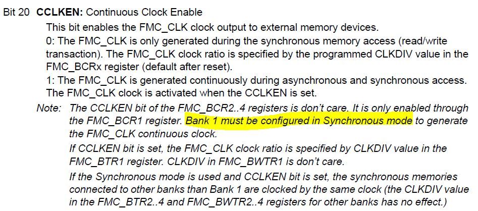

To be able to enable the continuous clock generation, first switch to the Pinout view and set to burst read (or burst read write) the Clock mode of the memory for which the Chip Select mode is set to NE1.
Parameter Description:
There is only one continuous clock enable bit located in sub-bank Bank 1 - NOR/PSRAM 1.
We than check the device reference (stm32h743), it also says that BANK #1 should be configured as synchronous clock.
So, the question is:
Is it sufficient to configure bank #1 clock as continuous clock, or is it also required to configure it as synchronous ?
If the 2nd option is the correct (bank #1 must be set as synchronous), does it mean that we can't keep using bank #1 as asynchronous, only because we need bank #2 to have continuous clock ?
