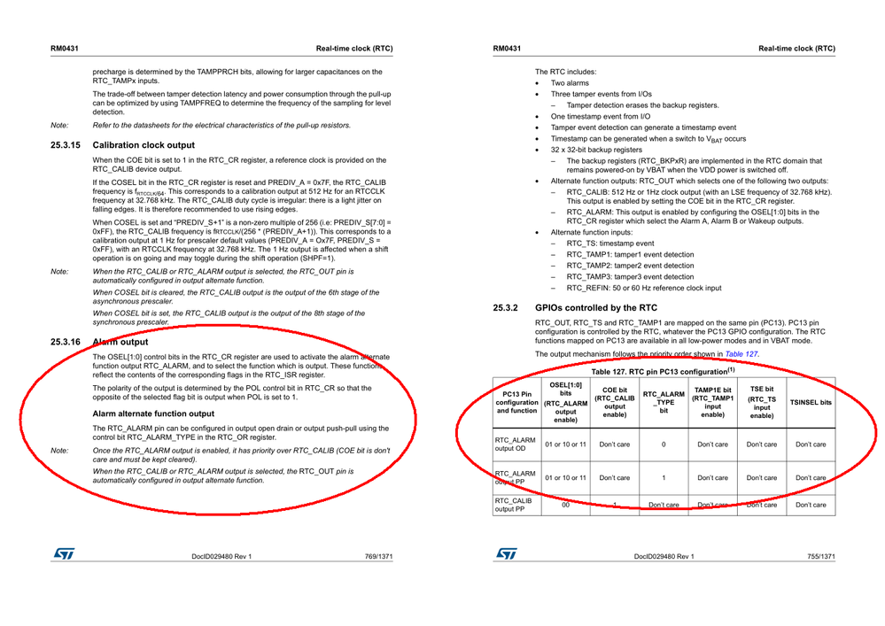

waclawek.jan
Super User
0693W00000UoLGjQAN.png?
Rookie38
Associate III
Thank you very much for the hint. I should have looked directly at the reference manual instead of the processor data sheet. As soon as I have read more about the functionalities of the RTC, I will start the implementation.
