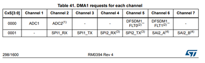

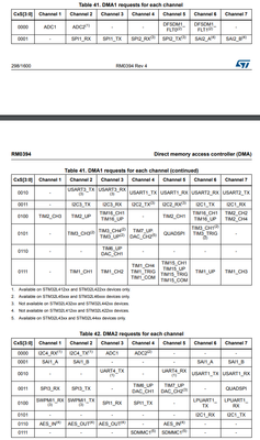

Ok thanks:
If you look at the reference manual RM0394 tables 41/42, there is no DMA request to the CAN peripheral:
So no CAN transfers with DMA.

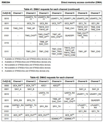

2024-04-03 2:31 AM - edited 2024-04-03 2:45 AM
Ok thanks:

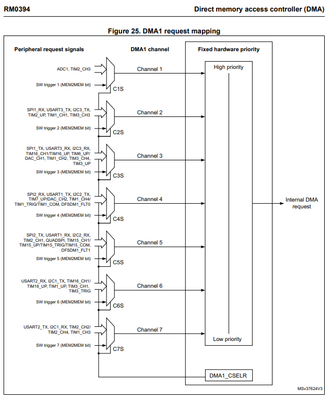

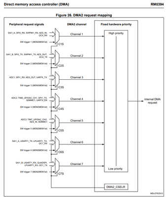

Tables 41 & 42 show you which peripherals have DMA capability:
See also Figures 25 & 26:
