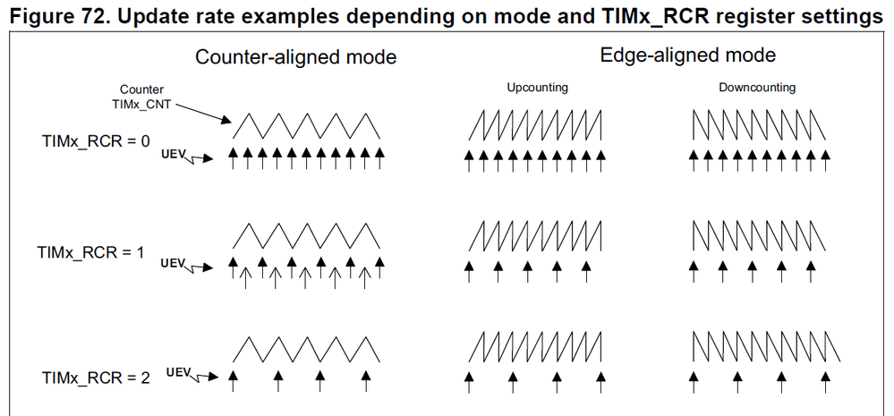

If the timer has one (which TIM1 does) you can set RCR to 1 to get an update event/interrupt on 0 but not ARR.

Hello TDK,
Your suggestion also works, thanks a lot !!
