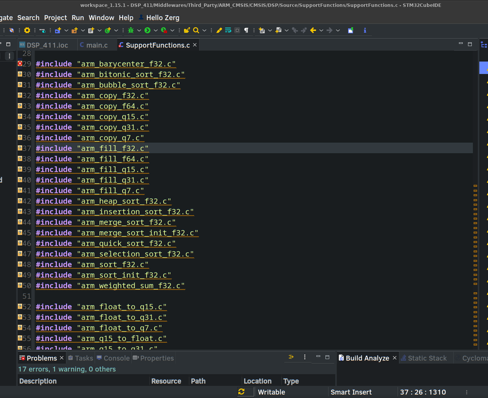

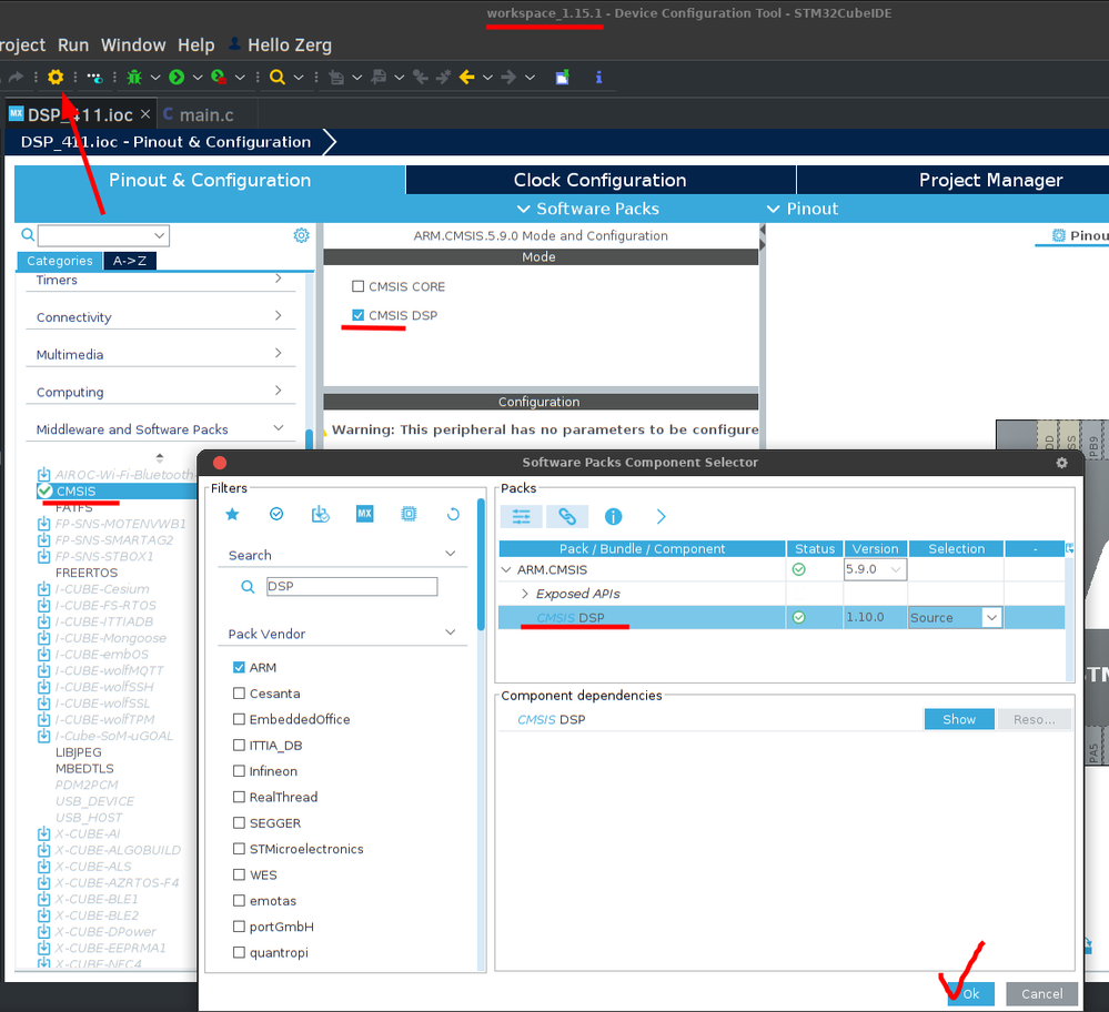

I'm asking because I've done the steps shown in the screenshot. But, many libraries are missing!

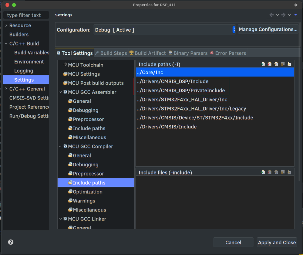

You can add the CMSIS-DSP library not only by using STM32CubeMX but also you can use CMSIS-DSP library located in \STM32Cube_FW_F4_V1.28.0\Drivers\CMSIS and add it by following this article " How to integrate CMSIS-DSP libraries on a STM32 project"

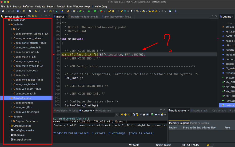

I did everything according to the instructions! https://community.st.com/t5/stm32-mcus/how-to-integrate-cmsis-dsp-libraries-on-a-stm32-project/ta-p/666790 I use the function from the connected libraries, and I get the following message: reference to `arm_rfft_fast_init_f32' undefined !
But if I do right-click on the function and select “Open declaration”, it opens the correct location of the function!

Update your toolchain and restart a new project. Make sure that you have commented out all the includes.
Can you please share your project?

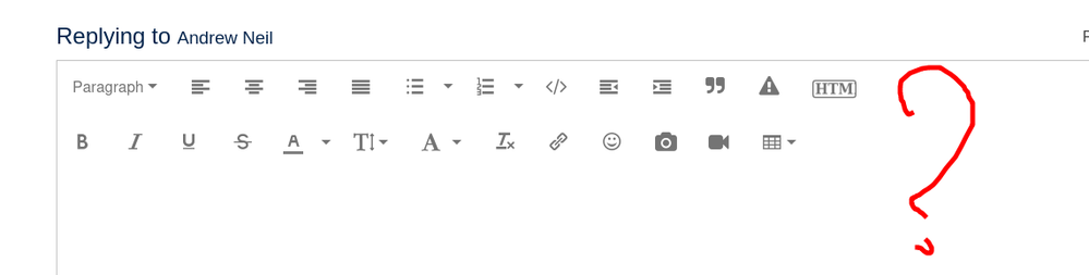

You could just attach a Zip file here
2025-01-23 6:56 AM
First of all, did you try updating your toolchain and restarting your project, and it didn't work?
2025-01-23 6:58 AM

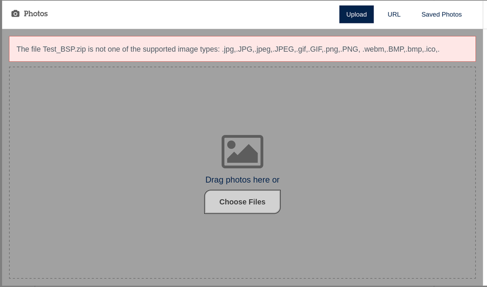

I don't know how to attach the .zip file here?
2025-01-23 7:07 AM - edited 2025-01-23 7:12 AM
Hmmm ... It should work:
PS:
reported here:
https://community.st.com/t5/feedback-forum/attaching-zip-files-broken/m-p/765176
2025-01-23 7:07 AM
Normally zip file is supported? Try to share it in .rar then..
