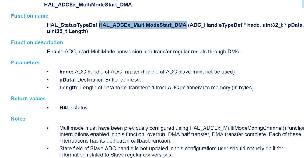

I'm new to ST-MCU, so I don't fully understand how to use the HAL API. Especially when using the ADC in dual mode, the API function to use is unclear.
Is there any sample code or documentation for HALAPI?
I can only find simple documentation. (Attachment document :UM2570 Description of STM32G4 HAL and low-layer drivers)
Thanks in advance.
