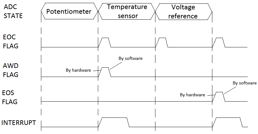

2019-06-25 12:23 AM
I understood.
I have a three ADC conversion:
I have a two flag which generates interrupt:
AWD flag is generated at the same time as the EOC flag. Timing diagram:
Because is generated two interrupts.
