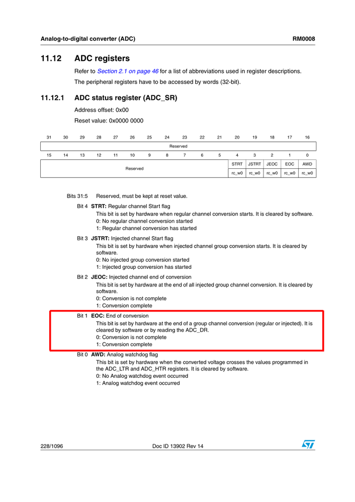

2023-03-28 5:18 AM
> Where can I read more about the meaning of EOC, EOS?
In the ADC chapter of Reference Manual, these are flags of ADC_SR register.
The 'F103 ADC is different from the 'F4 ADC. The Cube/LL functions may be somewhat misleading, as the 'F103 ADC does not have the EOS flag.
2023-03-28 6:19 AM
The other way around: does not have the EOC flag, if I'm correct. At least the compiler didn't let me compile functions with EOC, just the EOS ones.
But when running in regular scan mode one has to use DMA, right?
2023-03-28 8:02 AM
As I've said, the Cube/LL functions are misleading.
Not necessarily, but it's probably the most reasonable approach.
