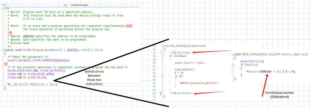

We found out the problem finally. It's caused by an uninitialized pointer and a race condition.
We have an led toggling in the systick callback to monitor whether the code in it completes on time. And we used a custom gpio library that accesses gpio with bitband address. However, i forgot to check whether the bitband pointer is initialized. An uninitialized pointer points to 0 address, so the first 4 bytes in the flash gets erased.
The picture below describes the whole problem.
