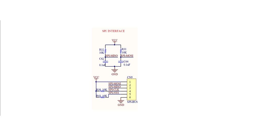

I am using
Cubemx,
IDE:Keil 5
MCU:STM32F405 (using inbuilt SPI-1 engine).
Flash Memory:Atmel AT45DB041
MCU PIN's:
/**SPI1 GPIO Configuration
PA4 ------> SPI1_NSSPA5 ------> SPI1_SCKPB4 ------> SPI1_MISOPB5 ------> SPI1_MOSI*/GPIO_InitStruct.Pin = GPIO_PIN_4|GPIO_PIN_5;GPIO_InitStruct.Mode = GPIO_MODE_AF_PP;GPIO_InitStruct.Pull = GPIO_NOPULL;GPIO_InitStruct.Speed = GPIO_SPEED_HIGH;GPIO_InitStruct.Alternate = GPIO_AF5_SPI1;HAL_GPIO_Init(GPIOA, &GPIO_InitStruct);GPIO_InitStruct.Pin = GPIO_PIN_4|GPIO_PIN_5;
GPIO_InitStruct.Mode = GPIO_MODE_AF_PP;GPIO_InitStruct.Pull = GPIO_NOPULL;GPIO_InitStruct.Speed = GPIO_SPEED_HIGH;GPIO_InitStruct.Alternate = GPIO_AF5_SPI1;HAL_GPIO_Init(GPIOB, &GPIO_InitStruct);//---------------------------------------------------------------------------------------------------------
void MX_SPI1_Init(void)
{hspi1.Instance = SPI1;
hspi1.Init.Mode = SPI_MODE_MASTER;hspi1.Init.Direction = SPI_DIRECTION_2LINES;hspi1.Init.DataSize = SPI_DATASIZE_8BIT;hspi1.Init.CLKPolarity = SPI_POLARITY_LOW;hspi1.Init.CLKPhase = SPI_PHASE_1EDGE;hspi1.Init.NSS = SPI_NSS_HARD_OUTPUT;hspi1.Init.BaudRatePrescaler = SPI_BAUDRATEPRESCALER_2;hspi1.Init.FirstBit = SPI_FIRSTBIT_MSB;hspi1.Init.TIMode = SPI_TIMODE_DISABLED;hspi1.Init.CRCCalculation = SPI_CRCCALCULATION_DISABLED;hspi1.Init.CRCPolynomial = 10;HAL_SPI_Init(&hspi1);}
void SystemClock_Config(void)
{RCC_OscInitTypeDef RCC_OscInitStruct;
RCC_ClkInitTypeDef RCC_ClkInitStruct;__PWR_CLK_ENABLE();
__HAL_PWR_VOLTAGESCALING_CONFIG(PWR_REGULATOR_VOLTAGE_SCALE1);
RCC_OscInitStruct.HSEState = RCC_HSE_ON; RCC_OscInitStruct.PLL.PLLState = RCC_PLL_ON; RCC_OscInitStruct.PLL.PLLSource = RCC_PLLSOURCE_HSE; RCC_OscInitStruct.PLL.PLLM = 2; RCC_OscInitStruct.PLL.PLLN = 3; RCC_OscInitStruct.PLL.PLLP = RCC_PLLP_DIV2; RCC_OscInitStruct.PLL.PLLQ = 5; HAL_RCC_OscConfig(&RCC_OscInitStruct);RCC_ClkInitStruct.ClockType = RCC_CLOCKTYPE_HCLK|RCC_CLOCKTYPE_SYSCLK
|RCC_CLOCKTYPE_PCLK1|RCC_CLOCKTYPE_PCLK2; RCC_ClkInitStruct.SYSCLKSource = RCC_SYSCLKSOURCE_HSE; RCC_ClkInitStruct.AHBCLKDivider = RCC_SYSCLK_DIV1; RCC_ClkInitStruct.APB1CLKDivider = RCC_HCLK_DIV1; RCC_ClkInitStruct.APB2CLKDivider = RCC_HCLK_DIV1; HAL_RCC_ClockConfig(&RCC_ClkInitStruct, FLASH_LATENCY_0);HAL_SYSTICK_Config(HAL_RCC_GetHCLKFreq()/1000);
HAL_SYSTICK_CLKSourceConfig(SYSTICK_CLKSOURCE_HCLK);
/* SysTick_IRQn interrupt configuration */
HAL_NVIC_SetPriority(SysTick_IRQn, 0, 0);}Please refer above attached schematic.
Thank you.

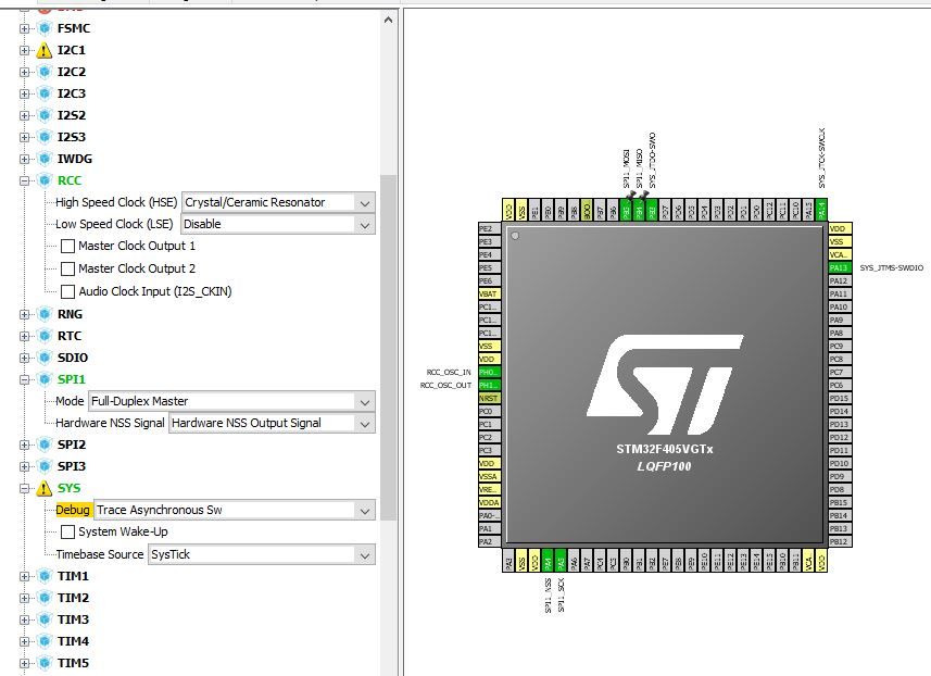

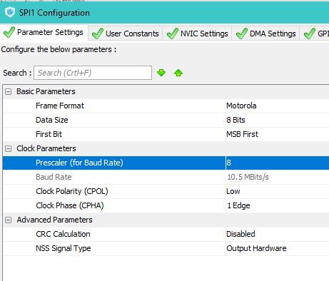

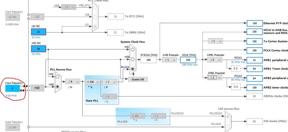

Hi Again!.
Sandeep i dont understand how this initialisation code produced.
RCC_OscInitStruct.PLL.PLLN = 3; // can 't be 3 does not have any sense .Begin from Basics .
Make a project at STM32CubeMX with your device (exact type)
put the value of your crystal in MHZ in the blue box and set clocks (eg like this)
And initialize your spi port
Make some other settings to produce code for KEIL
and generate the source projet
fully initialized
with theese setingsthen at your main function you can use
Majerle.Tilen
