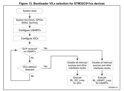

a) Yes, they're scanned in serial. If you are using one, you will need the others to be quiet. This is for the C0 which has only two devices but the others are similar.
b) No, there is not a timeout. It scans forever, as you can see in the flowchart.

The flowcharts in AN2606, forgot about / overlooked these.
It looks like using ST's bootloader might not be faster than building my own...
