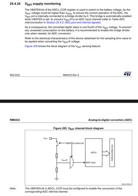

A quick comment, if you can check this :
Hope it helps you .

2024-01-29 1:54 PM
Hello @STOne-32 ! Thank you so much. I was actually looking at this signal at some point. I tried clearing it but didn't see it have any affect initially. I believe I was looking in the wrong spot. Now that I'm looking in the right spot, I believe it is performing as I'd hope. Thanks again. This is solved.
