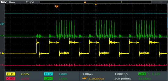

When I took out an oscilloscope and sampled a few of the pins, I found that some of the address lines were not working and some of the data lines weren't either.
Channel 1 (yellow): connected to PF2 (A2)
Channel 2 (blue): connected to PD5 (NWE)
Channel 3 (red): connected to PF10 (A0)
Channel 4 (green): connected to PF7 (A1)

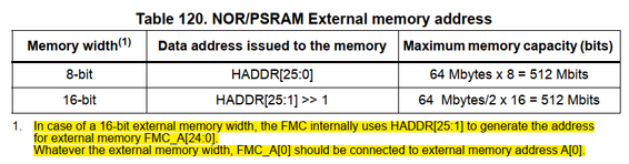

I understand the caveat here regarding the mapping of the address to the pins when we are set up for a 16-bit transfer, but even after taking that into account, there still seems to be an issue.

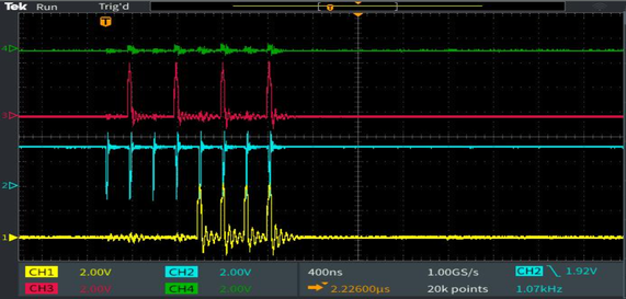

I've seen a similar anomaly on the data lines. I expect to see traffic on D0 and D1, but I do not. I do see traffic on D2, and a few other data pins, which tells me that at least something is working.
Channel 1 (yellow): connected to D2
Channel 2 (blue): connected to D0
Channel 3 (red): connected to D1
Channel 4 (green): connected an address line (for reference). I forgot which one, but doesn't matter here.

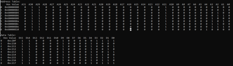

I printed out the first 8 address and data values from the for loop in the example code.
