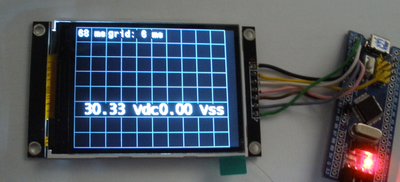

2025-06-22 12:18 AM
Right, see my pic...its just on a bluePill , F103 , 7 wires to display.
