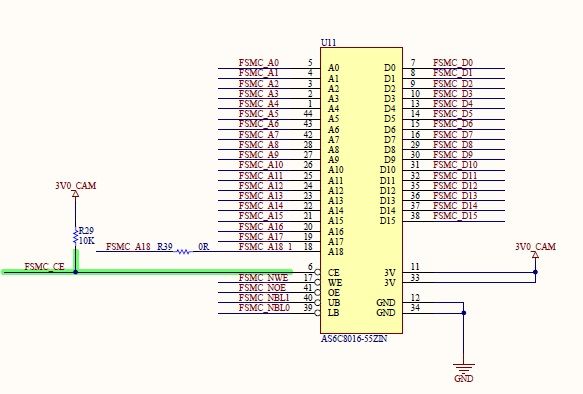

Let me try to make more clear.
I have interfaced the SRAM as per the schematic in attachment.
As you can see, I have used A0-A18 address lines, which is 19, as per simple math rule, total addressable area is 0 to 524287(2^19).
Now as per the data sheet, the SRAM we use - AS6C8016, has the 1MegaByte capacity. But with 19 address line I am able to access only 512KByte memory.
Accessing each address combinations(0x00000000 - 0x0007FFFF) on A0-A18 gives me 1 byte data only, so At present, total accessible memory with this architecture is 512Kbyte.
2017-02-27 10:31 PM
yes, I can see your diagram looks good.
and the problem is that pins A0-A18 are actually shifted inside the processor to A1-A19 (suggested by Clive)
So you can be sure your addressing is now 20 bits wide,
So the result is that your address range should be 0- 0xFFFFF
please try that,

I assume the issue is solved now. The datasheet i pointed to, explain how the signaling must be done. It's not explain how the MPU handle the byte control pins. I am sure that this are not just placed into the A0 line.
If i have a board that requires external sram, i will check up how the f4 handles this lines.2017-03-11 2:41 AM
