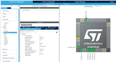

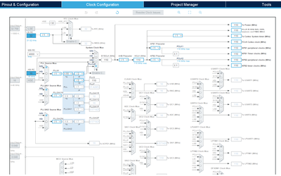

Hi @Tesla DeLorean @jumman_JHINGA @mƎALLEm
Sorry for the late response, the code you provided worked for W25Q256 and STM32F7 Nucleo. Thanks,
Now I have a custom designed PCB board where I have used STM32L56 and W25Q256 along with other components. First, I was using SPI for interfacing but it was taking so much time when writing/reading MBs file. So I have to opt for QSPI now. L5 doesn't have specific QSPI, but using OSPI we can configure it as Quad SPI.
So, my questions are
1) what is difference between QSPI and OSPI as QSPI (command and working mechanism)
2) will this code work for OSPI as QSPI
3) if you have any test code for OSPI as QSPI, I can test and will modify it according to my needs
Looking forward to your response
Below are my configurations, code files with changes accordingly.
