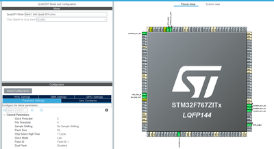

Hi Everyone,

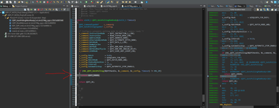

I interfaced Nucleo F767ZI with W25Q256JV using SPI and everything was working fine. But due to time and speed requirements, now I have to shift it to QSPI. I have used example code of STM Document named "QSPI_F769_discovery_flashloader" and developed a code for QSPI. But whenever I try to run the code and write/read the memory, nothing happens. I started to run code in debug on STMCube IDE and found that when try to send command to enable write and read status register, the register value doesn't change to write enable (0x02).
Always fail here and Error LED turns ON.
if (HAL_QSPI_AutoPolling(&hqspi, &sCommand, &sConfig, HAL_QPSI_TIMEOUT_DEFAULT_VALUE) != HAL_OK) {
HAL_GPIO_WritePin(GPIOB, GPIO_PIN_7, GPIO_PIN_SET);
return QSPI_ERROR;
}The Write Enable function is here.

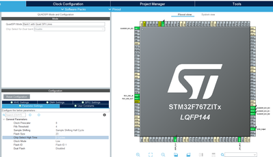

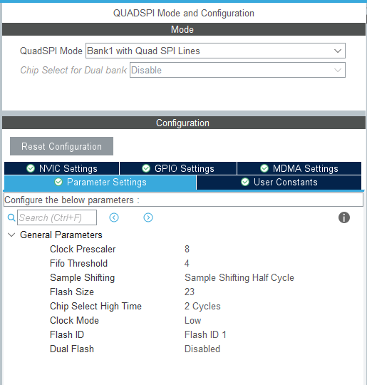

}Below is my attached qspi.h and qspi.c files and CubeMX configuration.
Kindly help me, what is the problem and if possible provide me a .c .h file for QSPI it's urgent.
Looking forward to suitable response, thanks in advance.

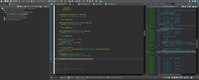

I have tested it and made some changes but still not working. When I used the "void testQSPI()" function to check if QSPI is working, it is not working as "static uint8_t QSPI_AutoPollingMemReady(uint32_t Timeout)" this function give QSPI_ERROR on the line
if (HAL_QSPI_AutoPolling(&QSPIHandle, &s_command, &s_config, Timeout) != HAL_OK)
return QSPI_ERROR;
in QSPI_AutoPollingMemReady(uint32_t Timeout).
below is my attached updated files. and debug results.
Looking forward to your response...

Yes it is tested. make shure you have configured QUAD SPI properly in the cubeMX. it should be like this:
Quad SPI W25Qxx Config

2025-03-22 12:02 AM

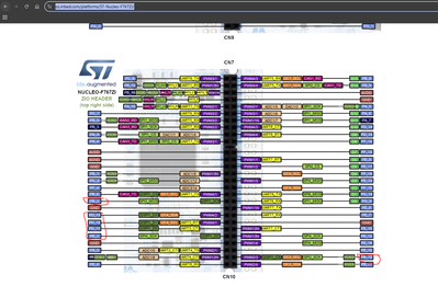

@jumman_JHINGA @Tesla DeLorean
I am following this link "https://os.mbed.com/platforms/ST-Nucleo-F767ZI/" to check out connection on my F767ZI board. As there is only QUADSPI in this board which can be mapped on the pins highlighted in the link.
I am using following PINS:
CS -> PB10, CLK -> PB2, I0 -> PD11, I1 -> PD12, I2 (WP) -> PE2, I3 (HLD) -> PD13, comparing this with pins mentioned in the link, do you see any connection problem on F767ZI board side? If not, then maybe it's on the flash side. Highlighted pins in the picture are used.
QSPI configurations are below.

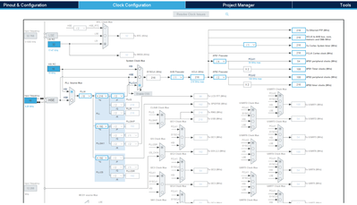

Sys Clk configurations are below.
These are all my configurations. Rest I am using all yours code without any change.
1) Does Sys Clk configuration have any error?
2) Does there is any connection issue on Board side like wrong pin for QSPI?
3) Does QSPI software configuration have any error?
4) If I use same code for 32MB flash, will it work (because commands are same throughout winbond W25Q series right?)? If yes, then upto 16MB region.
Looking forward to your assistance...
