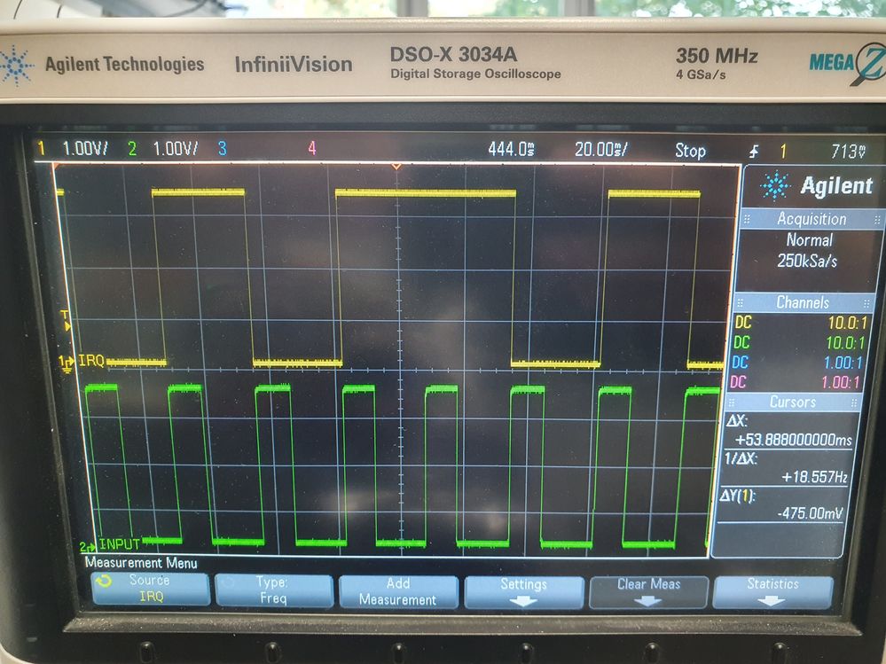

I use timer with input capture mode, to be able to measure time period of an optical encoder pulse. I experienced that measured value rarely is twice as the expected one. I tried with different timer prescaler values, but same problem remained. Suspected that interrupt service or input trigger signal is not proper, so I checked both of them (see measurement results below).
To check ISR, I put a gpio toggle function into the callback for a given pin I measured.
In ideal case, input signal should give a periodic pulse signal with a frequency value twice as the gpio signal made by the toggle pin function inside the callback.
It seems callback function is not called in every input. I did not experience if that skip should emerge in a periodical way. What could be the root-cause?

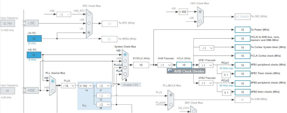

My clock settings:

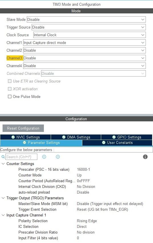

My TIMER_3 settings:
Measurement result (Input Capture input signal -- green; Capture Callback Function -- yellow)

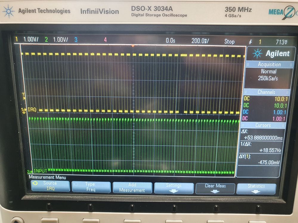

Measurement result (zoomed)

IMO you are missing interrupts because of lengthy TIM ISR execution. Maybe it's not the TIM ISR which is lengthy but there is another lengthy ISR with higher priority which kicks in.
Toggle the "debug" pin at the entry and exit of TIM ISR (not the Cube/HAL "callback" but the real interrupt handler) and observe.

..and set the cpu to higher clock ! now is only 16 MHz.
-> in Cube -> ckock tree : system clock mux -> PLLCLK
so ISR will be faster also.

Thank you, Guys! I did all of your suggestions, but the root-cause was actually that I directly read capture-compare register value in a function, called in the main loop. I had to put CCR content read method into the callback function, and now everything goes well.
2022-10-15 4:58 AM
Nice catch! Glad you got it going.
