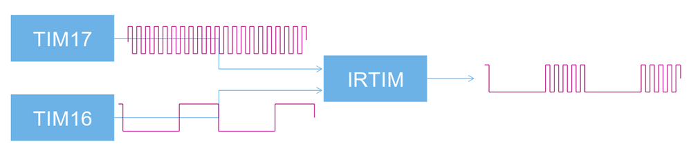

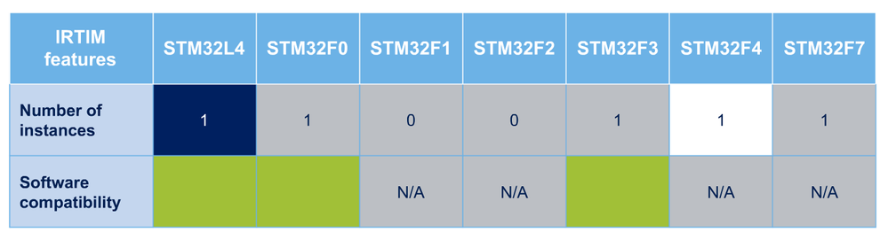

that it F4 MCU should have built-in periph for mixin PWM from two timers - one for carrier frequency and second for signal modulation.2016-10-26 12:24 AM
There is no uniform 'F4 family in this regard. If by F4DISCOVERY you mean the DISCO with 'F407 on board, or the other one with 'F429 (and a TFT LCD display), those are fairly old models which do not have this feature.
You can chain two timers, master providing modulation and slave the carrier, slave in gated mode. You then need to consider timing so that in the gaps the LED is not driven. JW2016-10-26 4:41 AM

There is no RITIM modulator in STM32F4xx device. The IR transmitter and receiver can be used in the STM32F0, STM32F3 and STM32L4 series.This is a wrong table, please refer to the online training on the official ST website at thishttp://www.st.com/content/st_com/en/support/learning/stm32l4-online-training.html
<After the reference manual as information source, I recommend the application note
and the related firmware he X-CUBE-IRREMOTE.Although STM32L4xx MCUs feature the IRTIM, the STM32L476G-EVAL board is not equipped with the necessary IR components. The X-CUBE-IRREMOTE therefore does not support this EVAL board.
