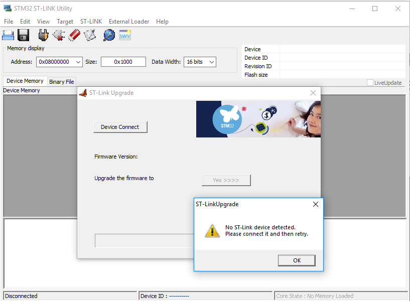

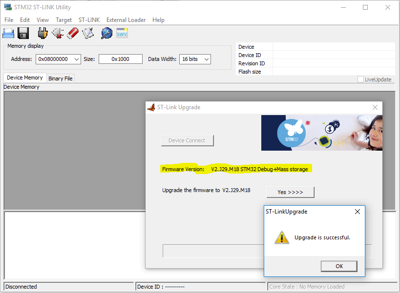

My computer OS is Win10, 64bit .For STM32 ST-LINK it won't able to connect with STEVAL-IDI002V2(STM32L1) Device and also in device manager STEVAL-IDI002V2(STM32L1) Device did not recognize.But stm32nucleo board successfully detected and showed in device manager.
This is the output image of STM32 ST-LINK when IDI002V2(STM32L1) Device going to connect.
This is the output image of STM32 ST-LINK when stm32nucleo Device going to connect.
I checked the STEVAL-IDI002V2(STM32L1) Device with the Windows 7, still have the same problem. Please help me to find the solution for solve this problem.

I don't think this board embeds an STLink.
You need to use an external tool to program its MCU.
