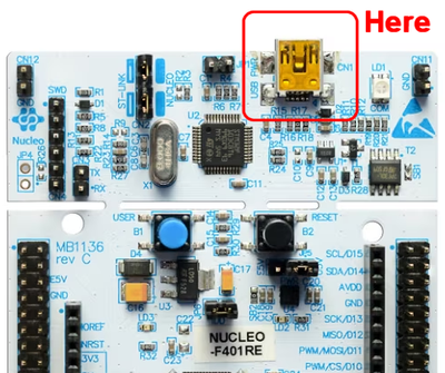

2024-07-03 8:55 AM
Im conecting the MKI through the IKS's DIL24 and the IKS on the nucleo's Arduino pins, and im unpluging the nucleo-pc cable
2024-07-03 9:02 AM
So you're unplugging the USB cable from the built-in ST-Link on the Nucleo board ?
So long as you don't do that during programming, that shouldn't be a problem.
Probably not a good idea to do it during a debug session.
2024-07-03 9:20 AM
Yes, I unplug that one.

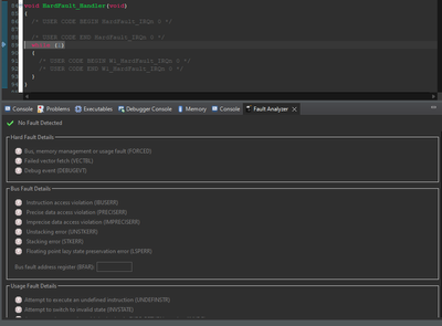

void HardFault_Handler(void)
/* USER CODE BEGIN HardFault_IRQn 0 */
/* USER CODE END HardFault_IRQn 0 */
while (1)
/* USER CODE BEGIN W1_HardFault_IRQn 0 */
/* USER CODE END W1_HardFault_IRQn 0 */

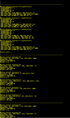

So, when fresh compiled, the code works giving this output:
But after that, it will only display this:
2024-07-05 1:11 AM

2024-07-08 12:05 AM
Ironically enough, the fault analisis display no faults... While i'm on the HardFault_Handler
