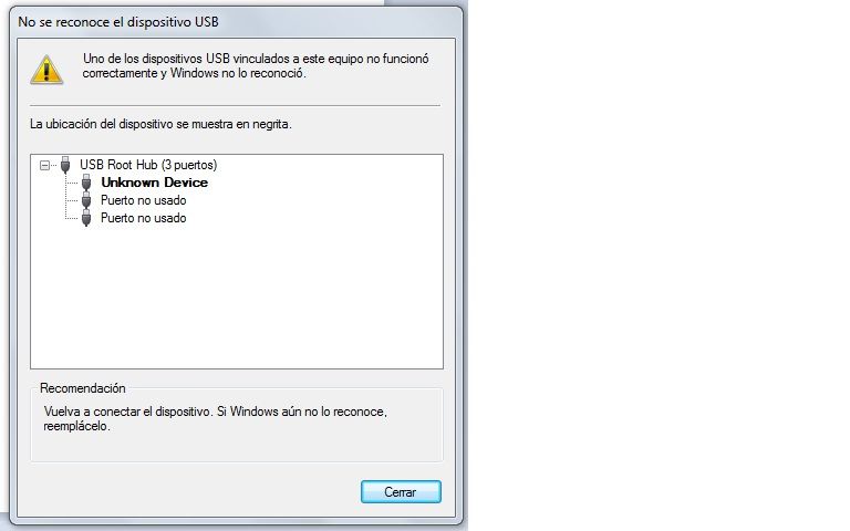

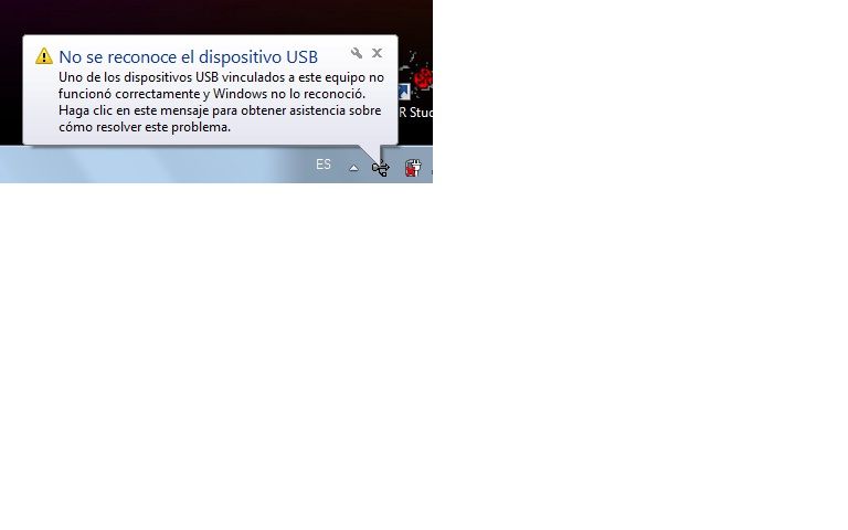

But, my main problem is that board does not work with St link utility. i pluged, it starts blinking, but st-link utility does not recognize. is like stlink, on board does not have Bootloader or firmware that manage the usb protocol, is it possible. let me put a picture. sorry about but my native language is spanish, and how you see, my operating system too. And it is that i cant undestand??2011-10-20 10:42 AM
Hello, maybe reinstal the st-link driver, you can fine in the ST weeb page.

actually, i did it.
you know what??? i change my usb cable, and guess what?? windows recognize stm32vl as massive storage. olso, i could compile the demo on atollic.... but,,,, unfortunately i can not program or debug it.. really, it is so wear... i hope someone knows the answer??2011-10-21 10:59 AM
