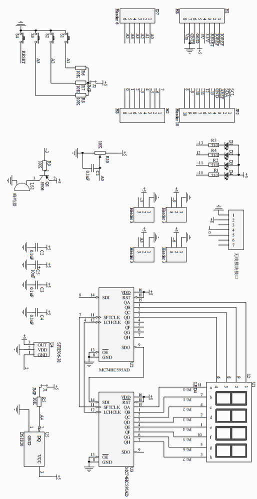

2023-05-13 3:07 AM - edited 2023-11-20 6:12 AM
this is the schematics of my Arduino Multifunction shield, and i just connect it to my stm32l053r8t6. Can someone teach me how to display my 7segment? Im already set the pin (PB5, PA8, PA9) to the gpio_output. Now i can only display numeric numbers, how to display characters?

2023-05-13 5:57 AM
But are the conceptual issues here STM32 related?
You've got a 16-bit shift register, one half is uses to select the digit to be selected, and the other half the 7-segments to illuminate.
You keep an MCU side buffer, and cycle thru the digits continuously, frequently enough for the scan/persistence to work.
Shift registers are a basic concept. You drive a bit, clock it into the chain, and then there's a latch to move the shifting register into a holding register.
Make sure you've properly initialized the GPIO pins.
If you have a scope or logic analyzer perhaps use those to confirm or review your understanding.
