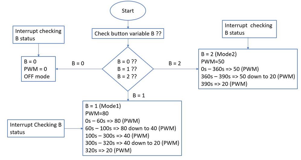

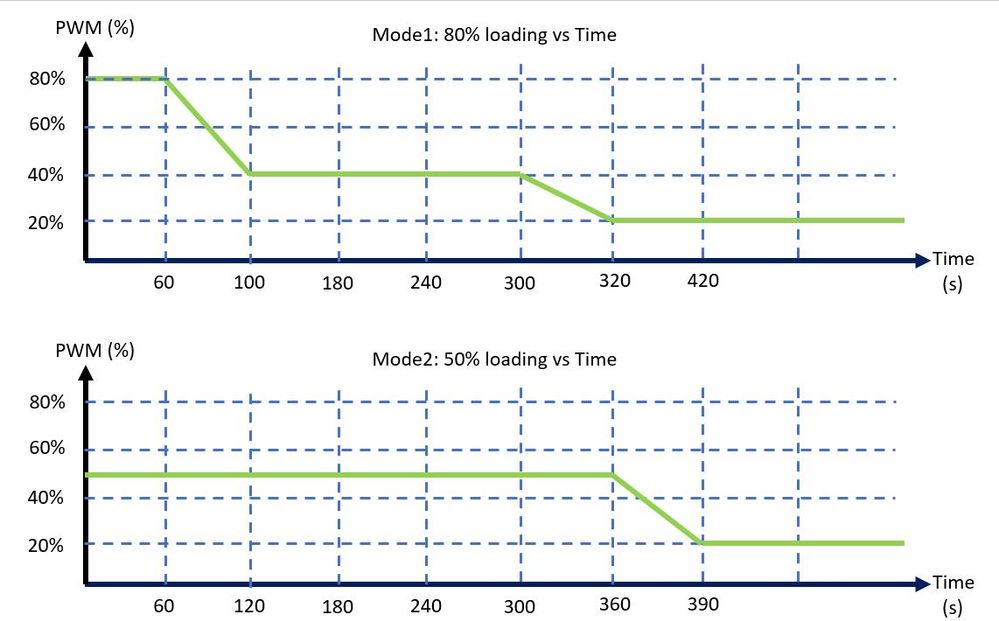

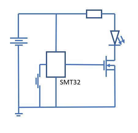

Three mode:
Mode 0: Off
Mode 1: 80% loading (PWM)
Mode 2: 50% loading (PWM)
Frequency: 10KHz
Cycling mode (push button):
Mode 0 -> Mode 1 -> Mode 2 -> Mode 0 -> …. -> ….
When push the button, it will change the next mode immediately.
If I use the delay loop in each mode, it cannot jump to next mode immediately.
How can I do?

Decimate the delay and check the button more frequently, and exit the delay promptly when needed.
