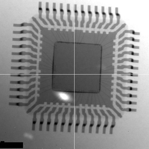

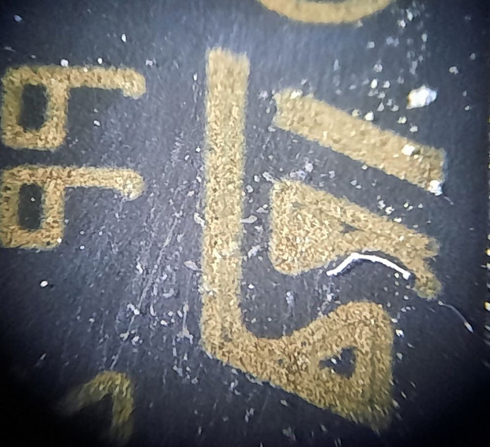

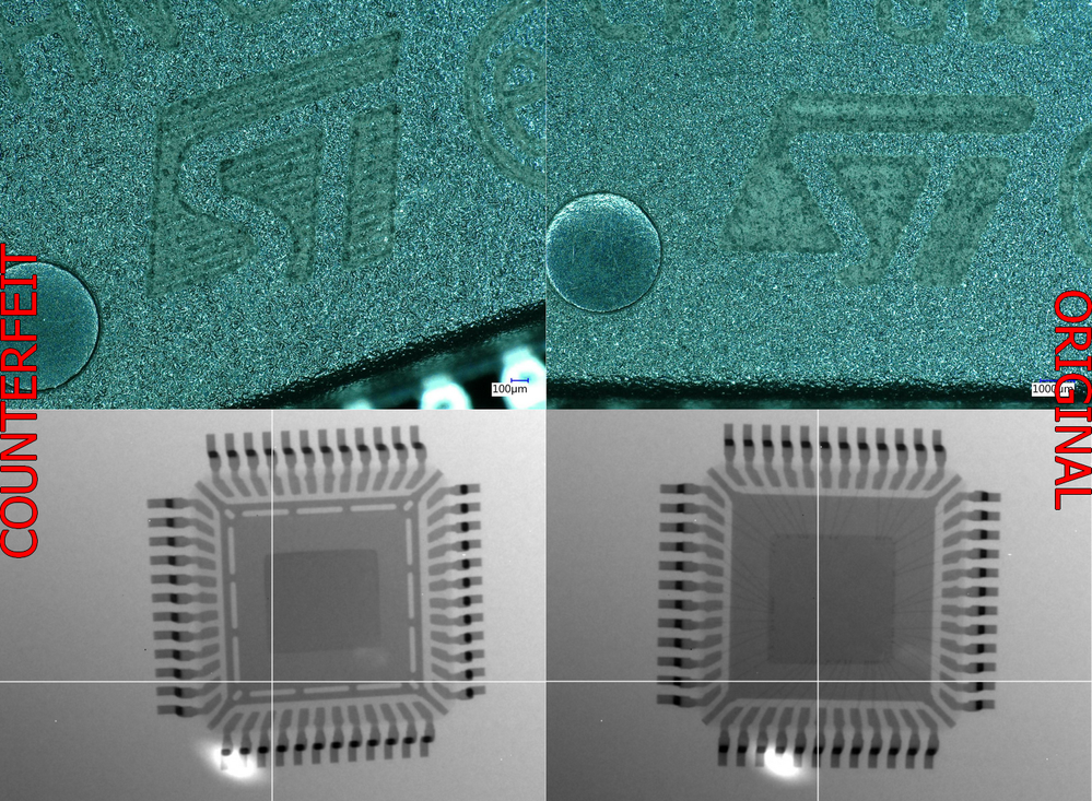

I just wanted to round up the subject. Turns out they are counterfeit. So here are a few details incase it helps anyone in these times:

All other devices claiming F103 compatibility I have seen have a newer Arm Core revision. The RomTable PIDR is also different often with ARM as JEDEC designer versus ST for a genuine part .

Just another followup incase anyone is interested. We got another batch that I could verify as original. The engraving and die substrate look a bit different but were verified as original by ST.
