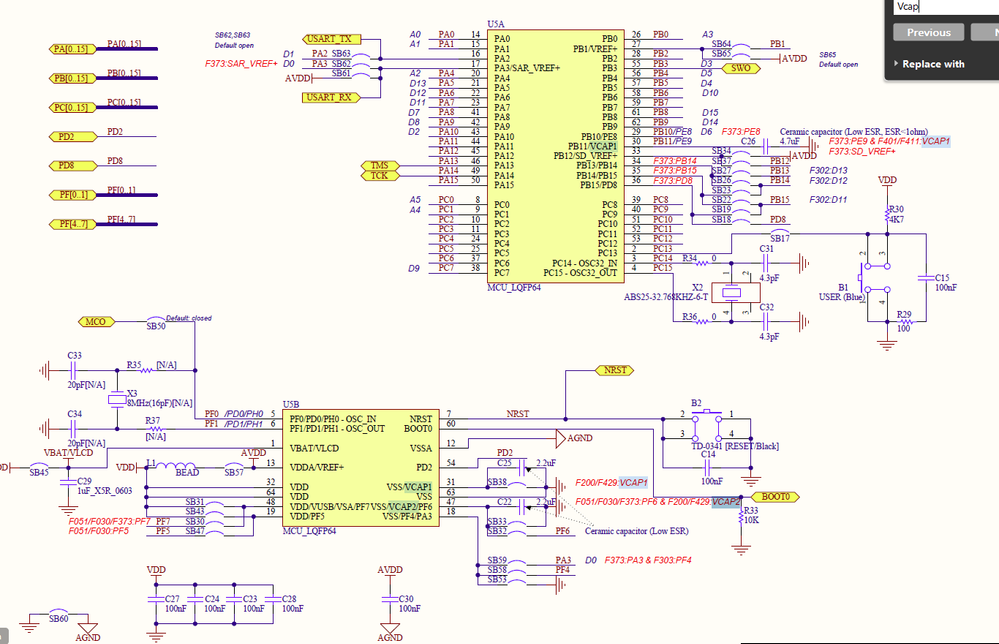

Check the voltages to the chip.
Check voltages on VCAP capacitors.
Check level on NRST.
Do you have the skills to desolder and replace the STM32F401 device?

VCAP1(30) should be around 1.20-1.25V on a working part
NRST should remain HIGH
