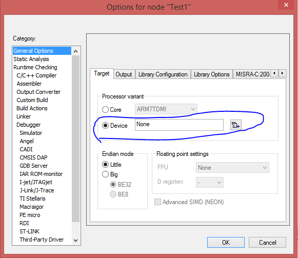

Hello everybody!
I am trying to work with stm32h743ZI with IAR V7.70.1, While trying to configure IAR settings 'options' I can't find (at options > General otions) STM32H7 with the target processor devices from ST
Is there any package I need to install to allow me to choose the right chip I am using? or any other solution?
Thanks in Advance.

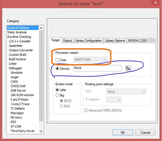

Hello everybody,
I encountered a similar problem. But my situation is a little different. I have a license for "7.70" and I have to use this license.
Is there any method?
2019-03-06 7:44 AM
Does it support Cortex-M7? Find a close proxy and use that, and adapt the memory map.
STM32Cube_FW_H7_V1.3.0\Utilities\PC_Software\patch\EWARM\EWARM_v7_STM32H750xx_Support.zip
2019-03-06 7:49 AM
Can you select "Cortex-M7" as a Core?
