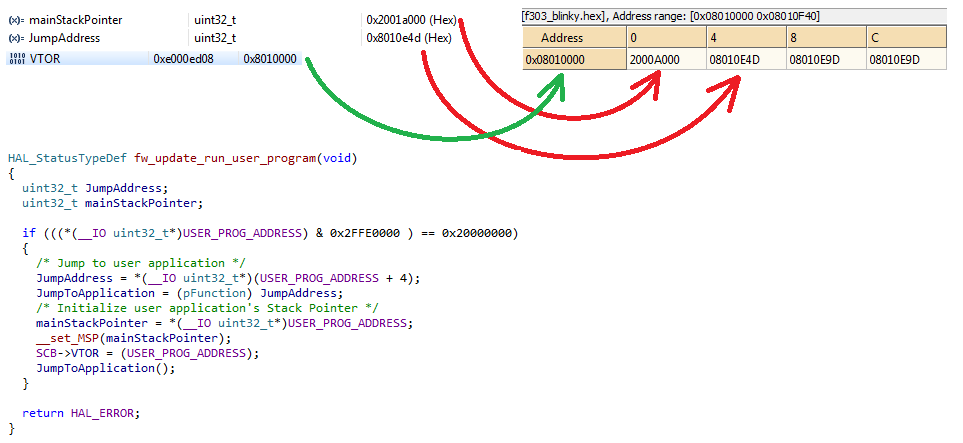

I have modified the code slightly. This is what I got from the debugger.
2017-08-15 9:36 AM
That's not going to help if code in your app changes it. Step into the application code and follow it through to main()
Make sure you don't call from within interrupt context.
