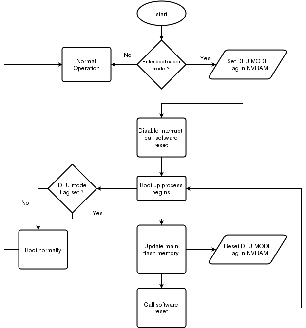

Lately, I've been trying IAP over UART using Ymodem protocol for STM32F072C8 SOC based custom board. The goal is to try IAP with this mode with different upgrade scenarios and later transform these into my actual requirement. I was able to successfully perform IAP using ST provided libraries, IAP driver and template (More information can be found
/public/STe2ecommunities/mcu/Lists/cortex_mx_stm32/Flat.aspx?RootFolder=https%3a//my.st.com/public/STe2ecommunities/mcu/Lists/cortex_mx_stm32/Query%20on%20IAP%20over%20UART%20for%20STM32F072C8&FolderCTID=0x01200200770978C69A1141439FE559EB459D7580009C4E14902C3CDE46A77F0FFD06506F5B¤tviews=27
) After this, I tried to put two different application firmware along with IAP driver in the main flash memory and was also able to jump from IAP driver to application f/w1 or f/w2. The memory layout that I'm using currently is as below: Table1: memory map of main flash memory (Total 64 kB)Table2: memory map of SRAM (Total 16 kB)

Please advise on what could be going wrong here and also any pointers on this overall design. Basically I would like to have
status = FLASH_ErasePage(0x0800E000);
while
(status != FLASH_COMPLETE){}
status = FLASH_ProgramWord(0x0800E000, 0xDEADBEEF);
while
0x08004000, instead of the default location (0x08000000)?

that I'm using the same SRAM location for both application firmware (fw1, fw2)I'm able to put the three(IAP driver, fw1, fw2) images in the main flash memory and was also able to jump from IAP driver to fw1 or fw2. Now I would like to implement the following logic (See the flow below)To achieve this, I should be able to store a variable in main flash memory at an address accessible from each of the three images (IAP driver, fw1, fw2). However, when I tried to set a flag at some address, which I think is not being utilized at the moment,in flash memory from application firmware 1 (fw1), the system hung (I think I'm getting a hard fault here, but I need to check). Code snip for storing 0x1 at some random address (note that this main flash memory address is within the overall range i.e.0x0800 0000 - 0x0800 FFFF)SOC: STM32F072C8 64kB Flash memory (ARM cortex M0 based SOC)Main flash memory requirement: IAP driver + fw1 + fw2Application f/w size: ~20 kB (Theoratically, I should be able to fit in IAP driver and two differnt application firmware in 64kB flash memory)IDE: KEIL uVision5 for windowsIAP Mode: UARTUtilities: fromelf.exe (For converting .hex files into .bin file), ST Programmer (for In-circuit programming using SWD interface) and Hyperterminal [1]Reference document: AN4065 [2]Update #1:I'm able to program the main flash memory from the IAP driver, i.e. the following works when I invoke these in the IAP driver, but not when I try to do the same in application firmware.Also, now I'm not able to debug the application fimrware using the KEIL uVision5 debugger window. None of the single stepping, step over, etc tabs are getting activated. Do I need to configure some changes for debugger, since my application now is loaded at #iap #iap #iap #solved2015-12-03 3:43 AM
