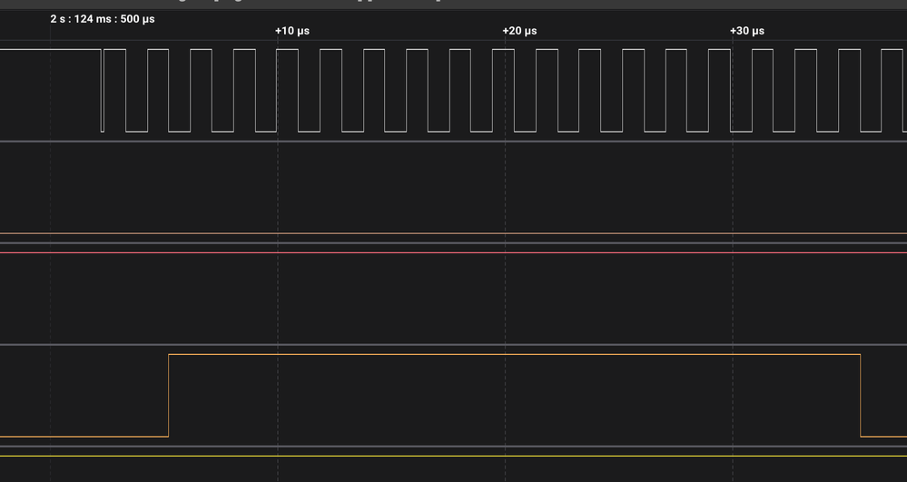

What is also interesting, readouts from logic analyzer seem to be correct.

Based on the waveforms you have attached: the very first cycle is "invalid", BCLK (WS) toggling for less than 16bit BCK. So, the startup (enable) has a "hick up", just reliable signals afterwards (after some cycles stable, keep running both in endless mode).

Btw, here is the start of transmission, where I made sure WS is pulled down low when I start both Tx and Rx.
2025-01-01 12:17 PM
A pull-down does not help: if the LRCK signal is generated it is Totem Pole (or Push-Poll). It is actively driven (not Open Drain output), so a pull-up or -down does not have any effect.

Your "problem" is: when all starts, the very first cycle is not correct (some BCK clocks but WS/LRCK changes - sure: now it goes to the 1st correct cycle).
This is due to the fact (for my understanding):
This creates a "kick-up" (incorrect first cycle). Your Slave Transmitter is confused and therefore the Master Receiver gets unpredictable Rx data.
