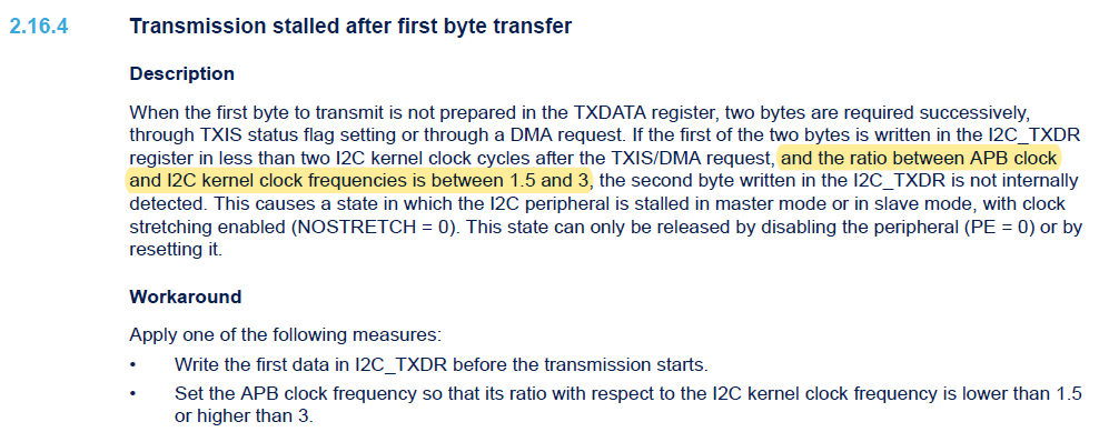

The issue has been fixed. The root cause was a defect in the STM32H743 silicon. The defect is included in the errata of other microprocessors, but not in the STM32H743 errata. However, STM has confirmed the STM32H743 does contain the same defect and they will update the errata in mid October.
In the meantime, you can view the defect description in the STM32H723 errata (section 2.16.4):
The workaround was to change the I2C kernel clock frequency so the ratio was not between 1.5 and 3.0.
