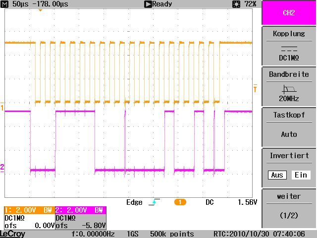

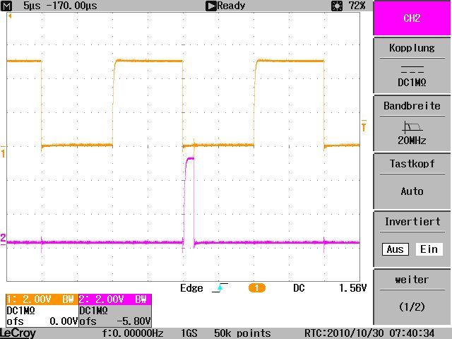

In the meantime i solved the unknown event problem. Seems to have something to do with the debugger connection. Without debugger no unknown events anymore but the sporadic bus failure is still there.
I now measured the bus and found some strange spikes on the SDA line after each 9th bit. I attached an image of the spike. I tested the communication on two different boards with different I2C slaves. But the spikes are always there. I also replaced my I2C code with the AN2824 code example but the result is still the same. Any suggestions ?2011-05-17 5:12 AM

Yes, sometimes the SDA line spikes ... and the I2C registers an event that not supposed to happen and I2C driver gets stuck waiting for the real event.
I timeout the event if the timeout reached I return FAIL ... and from the main loop if I2C operation Failed it repeats the I2C command again ...

Ok nice to hear I am not alone :) The strange thing is that the Spike is on
every
9th bit.2011-05-17 5:12 AM
I think the spike the bus master releasing the SDA line so that the slave can drive it to acknowledge the transfer.
2011-05-17 5:12 AM
Grin. Basically exposing the propagation delay in the bus, and the latency of the slave device. They are probably also ramming the port (0 states) with the 50 MHz driver, instead of the 2 or 5 MHz ones that might be more appropriate.2011-05-17 5:12 AM
