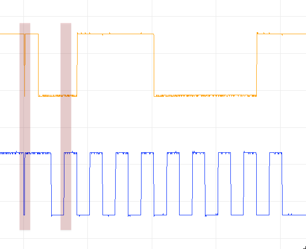

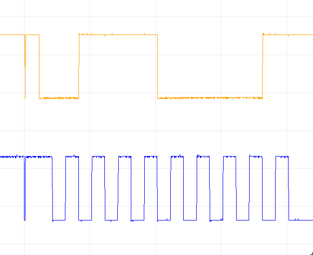

I am attempting to communicate via I2C to another ST device (LPS331AP) and read its sensor values. However, I am not able to initiate the I2C session properly. On the wire, I can see that the start signal is actually manipulating the clock line as well (you can see a simultaneous dip on both lines in my attachment). The result appears to show the master (STM32) zeroing the MSB of the intended slave address. The master appears to be addressing 0x38, while the slave address should be 0xB8.

Just to be clear, these are the regions of the waveform I am concerned with: The start sequence and the MSB of the slave address. I am still confused as to why the slave MSB is being sent as a zero.

Concerning your problem: * the double dip does not look good at all (GPIO switch glitches, I2C start glitches, I don't know) but I guess it would be better when they were not here. * one can see a nice start (sda going low during SCL high) * one can see that the byte being transferred is 0x70 corresponding to a write to slave 0x38. The I2C slave address is not 0xb8, this is the value to be sent a the first byte, the address is 0xb8>>1=0x5c. But if you called a function that requires the I2C address (0x5c) and gave 0xB8 as argument, the generated byte can will be 0x70, wiping the MSB, instead of the expected 0xB8. Check the code.2014-09-02 12:27 PM
