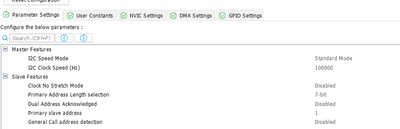

Master I2C device triggers slave transmit on STM32F101vft6. Using HAL_I2C_Slave_Seq_Transmit_(IT|DMA), in the AddrCallback, the STM sends length, 2 bytes, then sends message, up to 400 bytes. Common case is 22-28 bytes. I2C Bus set for 100KHz, using clock stretch, master configured for up to 20ms clock stretch by the slave.

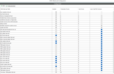

I have also tried setting NVIC to make sure I2C interrupts had the highest priority (based on some reading I did, implying this could be an issue).
