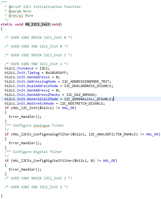

hi2c1.init.timing is overridden with:
I2C_GetTiming(HAL_RCC_GetPCLK2Freq(), BUS_I2C_1000k_FREQUENCY)

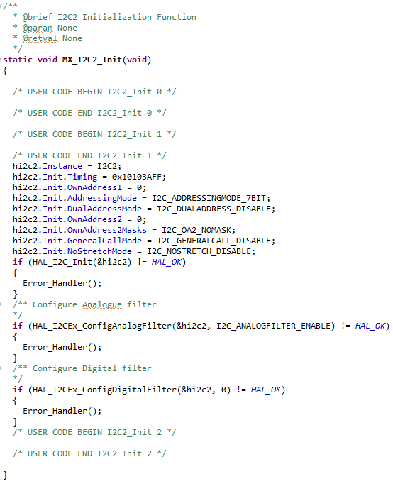

hi2c2.init.timing is overridden with:

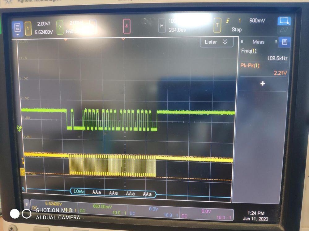

75% of the i2c transaction seem as expected with out clock stretching:

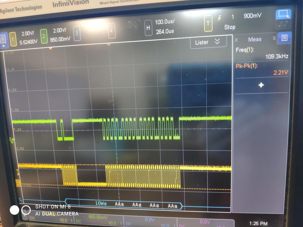

but 25% are with with long clock stretching:

timing is not really making any difference in stretching, slave is anyway synced using the master clock most of the time. It only stretches, when waiting for SW action, in this case it's for the address ACK. Check the ISR, what is the reaction on ADDR interrupt.
From the reference manual:
In default mode, the I2C slave stretches the SCL clock in the following situations:
• When the ADDR flag is set: the received address matches with one of the enabled
slave addresses. This stretch is released when the ADDR flag is cleared by software setting the ADDRCF bit
