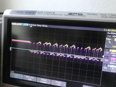

2024-07-19 9:17 AM - edited 2024-07-19 10:05 AM
I have 10k pull-ups.
Currently, everything is working. Here is a scope-shot of a successful transaction:
I really have no clue, why it did not work before. Before assume the 9th bit (ack) not being pulled down by my slave such that the address was not recognized and no further communication was being done. Still, the No-Stretch-Mode is not working.

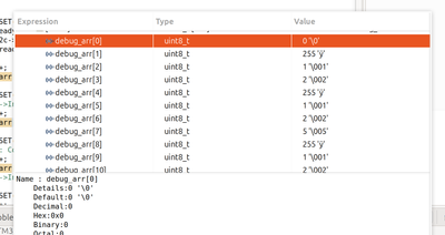

You see, that when I switch off the clock-stretching, I go to my interrupt-routine and have my debug-array filled with these values, which means, that I keep getting over/underflow-errors, although I write my DR everytime the interrupt triggers. Why is that?
It seems, that although reading SR1 and SR2, the Addr-Flag does not get cleared. I write to DR but it still triggers an error Interrupt that has bits 11, 10 and 1 set aka OVR, AF, ADDR. What is with this thing? My controller is connected to a lab-power-supply, has 100nF at every VCC, closly connected. Well I think I just go with stretching-allowed mode.
