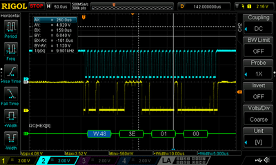

As you can see, here the example shows clock stretching - I have to work without this functionality.
The problem is, that my STM32 program is not working properly. The code for I2C slave device is provided below.
If HAL_Delay is called, the ACK is sent, but HAL_I2C_ListenCpltCallback is not called. If delay is not present the NACK is generated and Master can not proceed as desired.
This is what I can see on my oscilloscope after probe procedure is called on the master in case of no delay in the STM32 code and bellow in case when delay is present in STM32 code.
But as said, if ACK is sent STM does not call HAL_I2C_ListenCpltCallback (as it should?) and in case of NACK master can't go on (in real life situation).

What have solved my transmitting from slave to master issue was the pull-up resistor (8kOhm).
Pull-up resistor can be further optimized based on real application I believe.
Nevertheless, now in test environment I can communicate in both directions with enabled or disabled clock stretching.

Answering to myself and potential readers again.
So to avoid problems (note to readers and myself):
This topic can be closed now.
