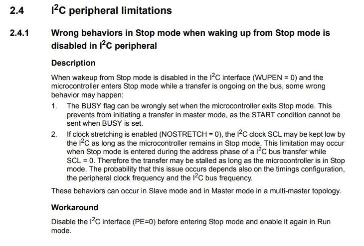

Hello @TJast ,
You can review the STM32L0 errata sheet related to your devices to check the known I2C peripheral limitations and if you have the same condition (If clock stretching is enabled).
When your question is answered, please close this topic by choosing Select as Best. This will help other users find that answer faster.

2021-08-22 7:01 AM
@Imen DAHMEN Thank you for the hint but in my case processor does not enter Stop mode. It must be something else.
