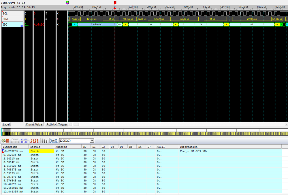

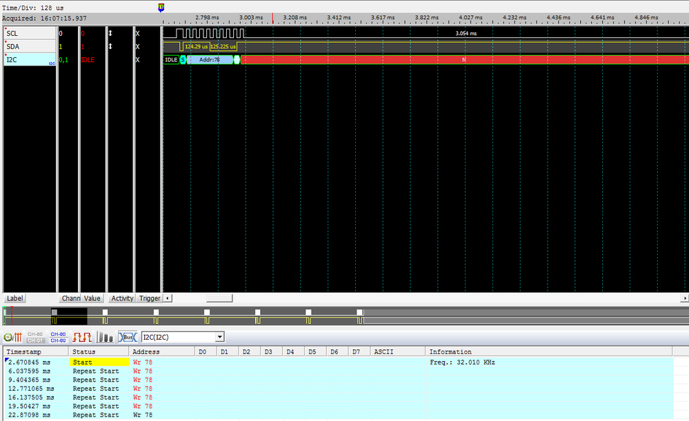

I have a slave device which is address 0x78 for write and address 0x79 for read.
I want to confirm that why the below I2C transaction is difference?I want to reset the slave device and the mapping register information as the below shown.Reset register (R/W)register address:0x3008register default value:0x021.The return data=0x00 is success when the address doesn't shift left 1bit#define OV5642_DEVICE_WRITE_ADDRESS 0x782016-11-25 4:43 AM

Dear JW:
Thanks for your responsed and the I2C can work after I stuied the RM0090 and the F427's spec. for I2C.Now, the I2C can access our device.We’re moving the ST Community to a new platform to give you a better and more reliable community experience.
