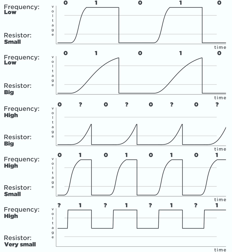

@PReka.2 "Is it ok to use inernal pullups to I2C communications?"
As noted earlier, they will generally be too weak - but you might "get away" with it ...
A thread on I2C pullups:
In that thread, this picture shows the effects of the pullup value:
