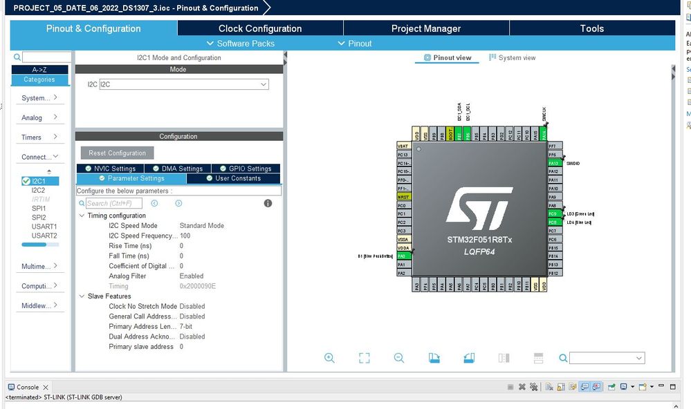

1 . I set configuration:
2 . Generate the code via Cube.
3 . Add one line of code:

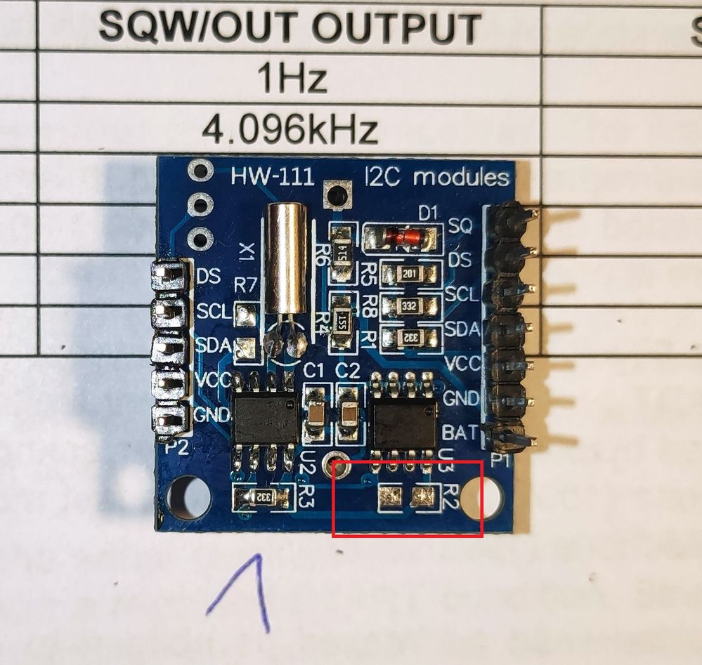

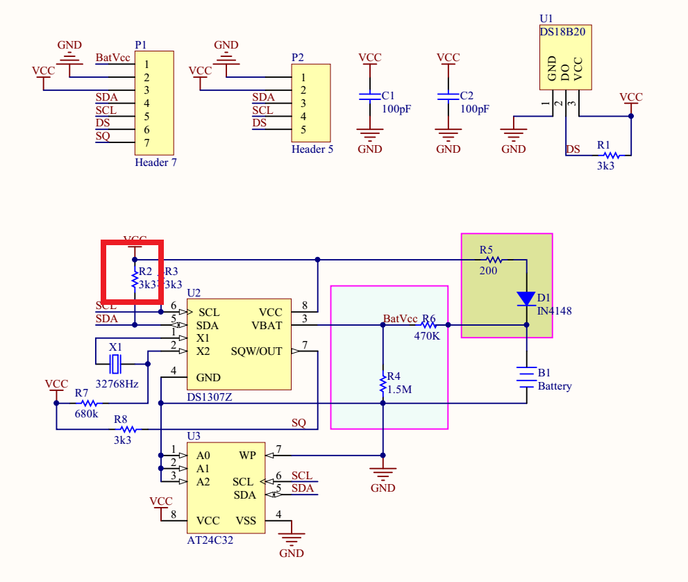

Oh, for bats's snacks, it was the pull-up resistors. It cost me a few days :-(. One thing to note - Arduino works well with the module, STM does not :-(.
R2 was missing.
