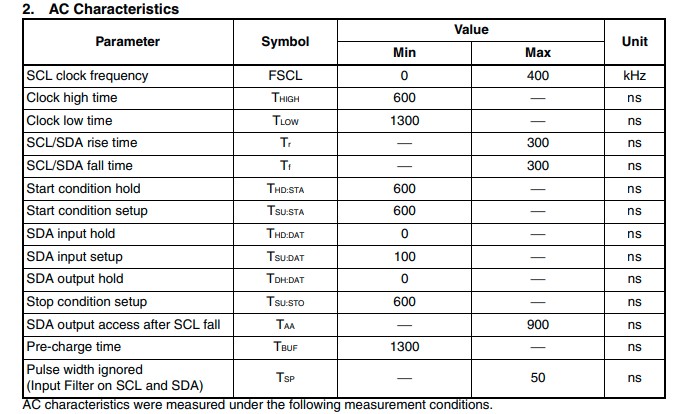

This is a bit of a shot-in-the dark, but since we're into an electrical problem and given that the chip connections seem fine I was looking through the data sheet:
and it seems like I'm exceeding some of the specs (my rise times Tr on SCL/SDA seem to be on the order of 2uS rather than the 0.3uS required by the spec, the start condition hold seems a bit border-line too).
Is it possible that my pullups are too high resistance and this is causing some sort of problem?

Seems possible. Using a lower clock rate would fix it, if it's an issue. Note that the 0.3us is for 400 kHz, and you appear to be using 100 kHz. I guess the scope trace isn't perfect.
