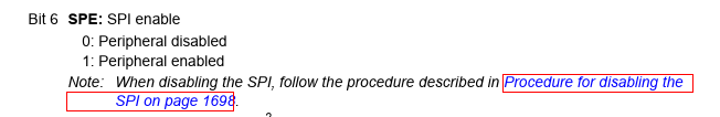

2023-03-27 2:41 AM
Oo - the stop condition is a problem .
the spi shift-counter should be reset, when spi is disabled.
try write to SPIxCR1 ->
there must be some way to reset the counter - otherwise you could never use spi again, if it got one spike on clk line or got one wrong sized word.
