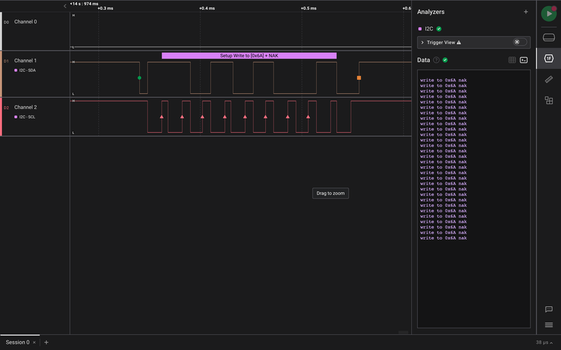

And now nothing works. I have used an oscilloscope to see whether there is a wiring issue but no every pin has its respective voltage. I recently also used a Logic analyzer to see what the data transfer on the bus is. Apparently the peripheral doesn't want to acknowledge the Address I'm sending (0x6AU <<1 / D5U), so it responds with a NAK bit.
When the return I get from HAL_I2C_GetError() is HAL_I2C_ERROR_AF which matches the logic analyzer output. Hear a link to my .ioc file. I will also attach my main.c file.

I figured it out. In the ISM330DCL u have to connect a certain pin to Ground or VDD so u can have 2 device addresses on the same I2C bus. Well, I didn't have it connected to either one so that's on me. Apparently it had an undefined state between VDD and Ground. All in all I had to connect the SDO pin on the EVAL board to Ground
