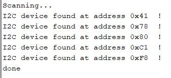

Also when I make a scan at Arduino, it gives some I2C addresses, I am not sure which one belongs to my STM32.
