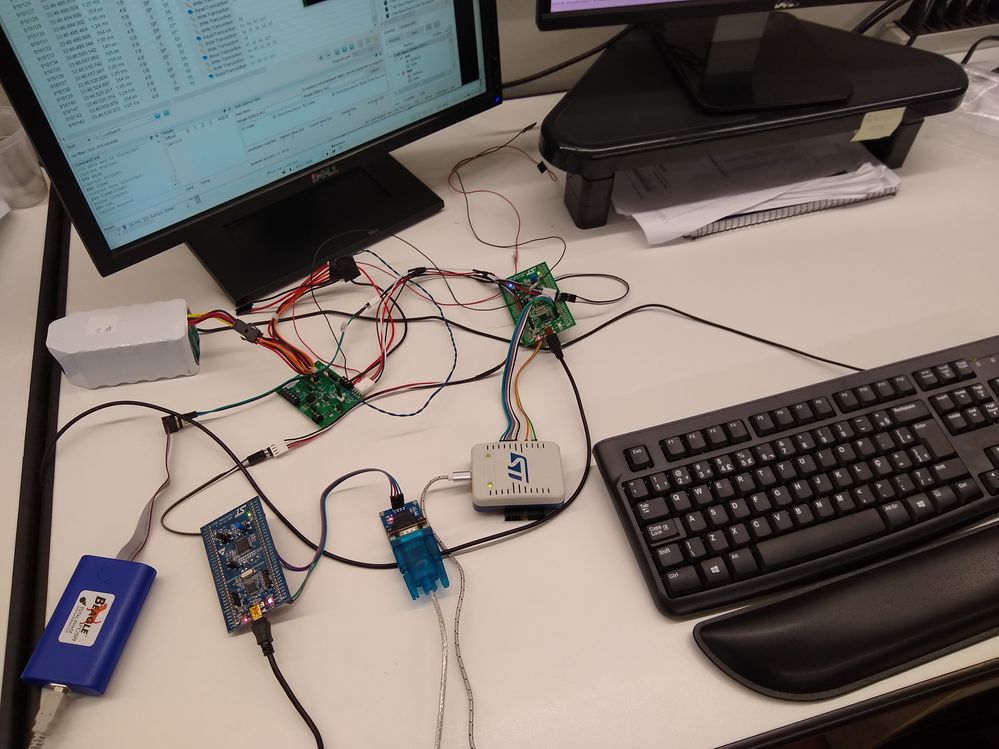

As a follow-up, I have implemented a recovery routine based on your suggestions above, along with some tips of answers in the link below:
https://electronics.stackexchange.com/questions/267972/i2c-busy-flag-strange-behaviour
In the end I disable the I2C interface using HAL_I2C_DeInit, perform the bus reset and restart the I2C using HAL_I2C_Init.
I have set a second Discovery to inject errors on the I2C bus. The error gen inject pulses on SDA and SCL at regular intervals while the main routine reads the slave continuously. I monitor the bus activity with the protocol analyzer and the errors are displayed. When a timeout is detected, the recovery routine is called. I left it running overnight and after around 12 million iterations it recovered from more than 500k timeouts and 13k AF errors. These were the errors I observed when I used the tweezers to inject errors.
Thank you for your help.
As it is not true if it does not have a picture... :grinning_face:
