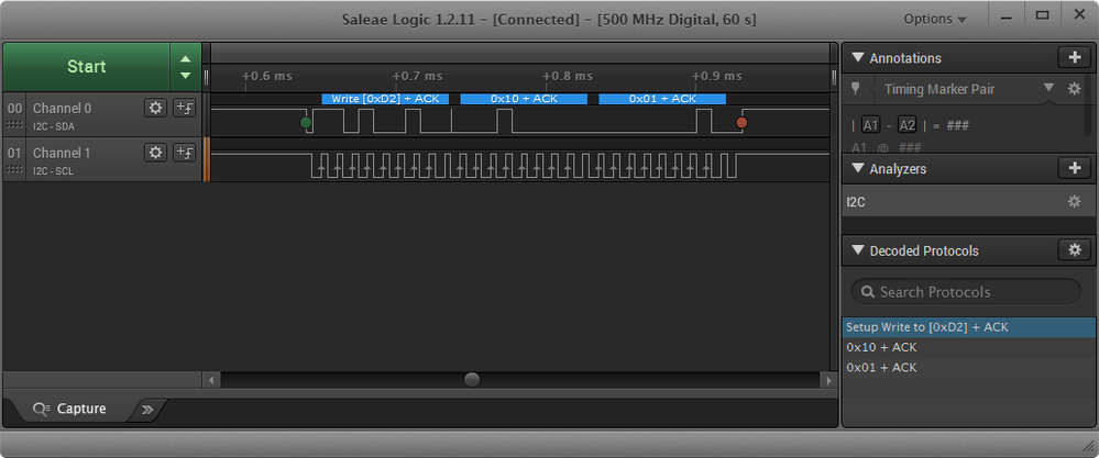

The logic analyser detects a ACK for the RTC.

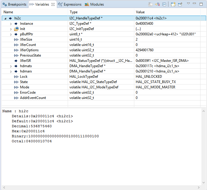

What's the content of hi2c1 and the I2C registers?
2017-01-19 1:32 AM
I made a snapshot of the variable, when the system runnes inside the HAL_I2C_GetState.
regards Roger
