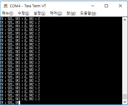

I2C_CR1 |= 1 << ACK; I2C_CR1 |= 1 << START; // /* Wait until SB flag is set while( !(I2C_SR1 & 1 << SB) );---------------------------------------------------------------------------
Finally, I start like this, set PE, set ACK, set START
But, SB flag dosen't set.
SR2's busy flag always set.
How I can solve it?
